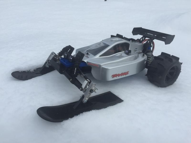

Idzie zima - zbuduj cos takiego: http://i241.photobucket.com/albums/ff28 ... 8ac4ef.jpg
https://www.youtube.com/watch?v=wOgknDV8QLU
